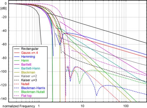

There are many different "types" of filters you can write, and the boxcar (or moving average, as you called it) or rectangular filter is only just one of 'em.
Here is a comparison of a variety of filters, and the kind of effect they can have on your data, as a function of frequency...
to make a simple "moving average" filter, you merely need to add up the data, then divide by the number of data elements.
If you add all the elements every time you calculate the average, it will cost you n additions plus one division.
On the other hand, if you keep track of where the oldest data is located, then as the data progresses, you merely add the new data, subtract the oldest data, and do the division again...
This method only costs you a single addition, a single subtraction, and a division. Much faster...
I won't write the code for you. I hope this helps, though...
