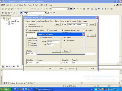

i'm using at89c51...... i found it in another version of keil3. but in the settings tab,its asking for HOST IP and PORT.... i gave another system's IP connected in lan but how to assign port. host com port is COM4.. in default its given 8000 in the settings.... can yo plz put down the steps to simulate via keil.... thanku very much for imm response

see...... i have entered the IP but.... wat to do in port BOX... i have attached the screen shot

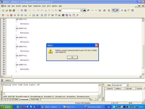

if i run the keil its displaying a error message like this

hi ajay & rearthur............ i got it man.. to simulate in same system we shouldn't change the ip(127.0.0.1) & port(8000)..... its working fine in keil3 & proteus 7.4.......... but its of no use, i can directly load the hex file into proteus for simulation......... is there any other use........ thanx in advance
