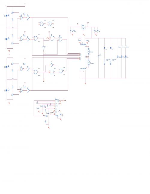

Thanx a lot ajay!! here is schematic of Solar Tracker
i wanna change the hardware design still thinking wat to do!! coz in this hardware there is a lot of use of wood i wanna reduce it.... did u have any idea??

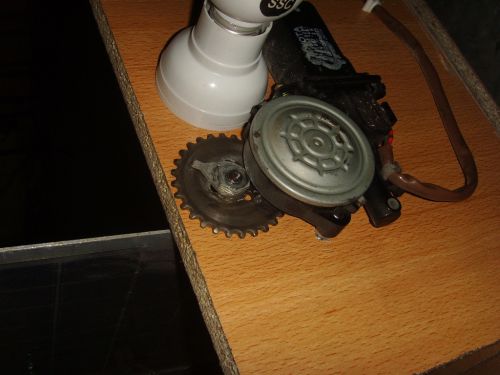

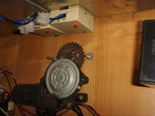

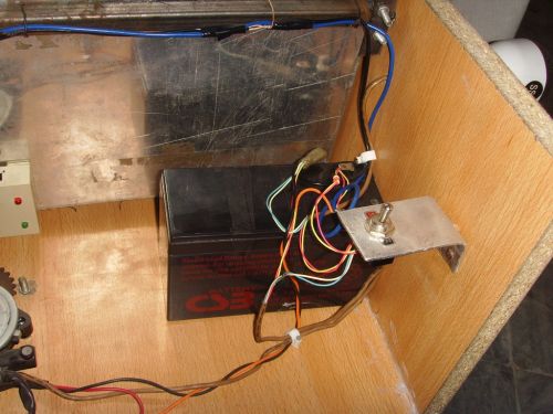

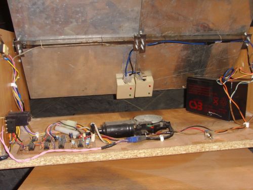

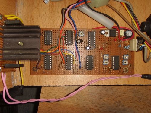

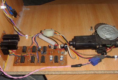

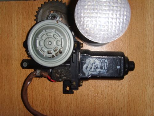

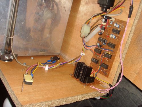

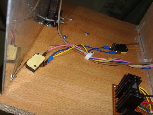

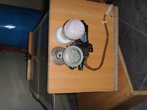

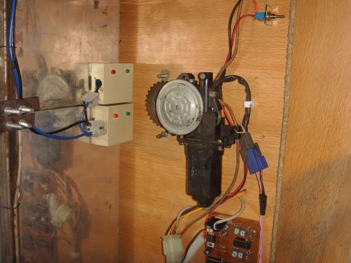

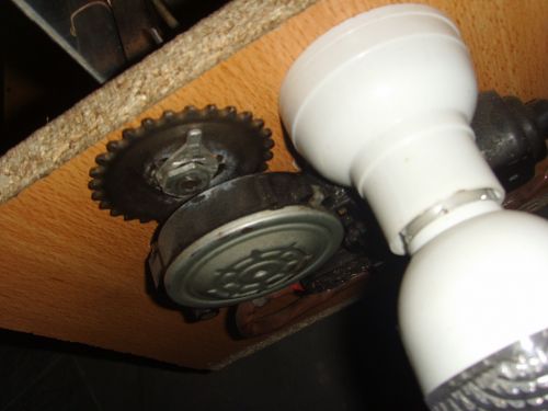

Here are some pics of Hardware and Gear system

Humm cool images dear sir from where you got the gear system?

it is totaly Desi type of Gear system!! Servo motor is used from car door mirror system and gear sytem is basically built using motorcycle chain small sprocket to rotate panel and a small camwood at servo side....

great work that shows an efforts of a real engineer
