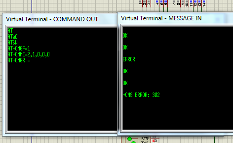

Thanks Kiran. But the problem now is tx0 function is supposed to output unsigned characters and yet i think the variable will be an integer.
i have tried to declare the (var) as an integer globally but wen the program runs the "AT+CMGR = " doesnt pick up the digit..so in the terminal it displays as shown in the snapshot below

var must be converted to ascii first before sending it to modem. and "AT+CMGR=" without spaces around '=' sign

For numbers up to 10 the best method is just to add 0x30 to the value.
EG
0 becomes 0x30 which is ascii '0'
1 becomes 0x31 which is ascii '1' etc.
For 10 or above use "printf", "sprintf" or "itoa"
"printf" will often add a lot of code so is best avoided.
